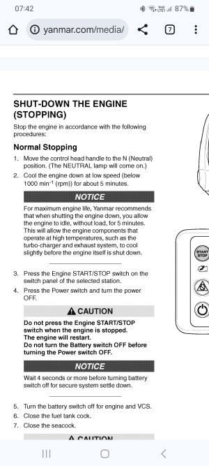

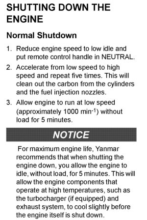

I see a lot of comments about under-working diesel engines being harmful to the engines. My Yanmar 8lv320's max at around 3,600 rpm but I operate at around 1,350 rpm almost all of the time. I do give them a few blasts at max revs in neutral before I switch off, to minimise sooting. On longer runs, of a couple of hours or more, I run close to max for 10 minutes or so towards the end of the journey. At 1,350 revs the engines reach a max temp of 76⁰ after around 10 - 15 minutes. If I push the revs above 2,500 the temp goes to 78⁰. My cat will comfortàbly do 20kts+ but 7 -8 suits me, and I don't want to change. Is there any more I should be doing to show them my love?
