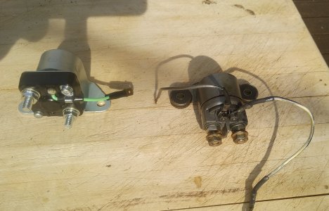

Engine No Starty...
oldgit
6 Nov 2001
28,647
Medway
Yanmar.
One of these relays is £200.00. The other is £20.00 and came within 48 hours from exotic parts in the deep South.**starter relay.jpg

And......did it work ?
(y)
Was going to knock something up with a ordinary vehicle relay and a Lucar or two , but purchasing this relay suggests to the casual observer that the skipper actually cares................................ a real pig to get at of course
Another "Genuine Yanmar" top quality Gold and Diamond encrusted relay conked out on the other engine last year.

For those interested the Yanmar part No is 129100 - 77910.
Fitted perfectly. 5 min job.
Going to order another as a spare.
Ebay.
Yanmar 129100-77910 Relay 12V Jideco 2538104-B​
