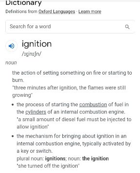

Read post #11 and the post i'm replying to please.
I am responding to the post you wrote, in a thread titled Easy Start, saying explicitly
a) that neither pre-ignition nor detonation can occur in a diesel engine, and also saying
b) that pre-ignition cannot occur because the fuel is injected at the correct moment.
You responded to a post i made, in response to a claim that adding petrol to diesel causes pre-ignition. The petrol is mixed with diesel, so cannot pre ignite.

Paul, you have a lot of detailed and informed knowledge of engines and electrickery, and I am, as I'm sure that many others are, very grateful that you share your knowledge on this forum, but here, in the post I have quoted, you have stated two things that are incorrect.
Why not admit you made a mistake in this particular instance? It's no big deal. We ll do from time to time.
I corrected your post not as part of some pissing contest but merely because most reading this read, now or in future, will be reading it to get information about the pluses and minuses of Easy Start, and likely not be in a position to judge what is true and what is not. Let go of your ego and see it from their point of view.
