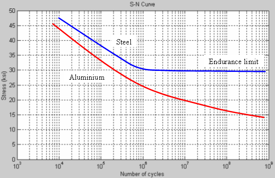

Fatigue
Assume:
  • The design load for my boat (Jordan page) is 8000 pounds.
  • 48 hours and two storms, so 96 hours.
  • wave period 15 seconds or a total of 24,000 cycles.
  • Typical load from a non-breaking wave is about 16% of design load. The wind load only on my PDQ is on the order of 800 pounds and I have seen anchor rode tension as high as 1300 pounds with much smaller waves.
  • The fatigue limit of 316 SS is about 30% of the tensile strength (I looked it up). At 24,000 cycles it's probably more like 35%. However, that 16% figure would be a COMMON occurrence. There will also be a large number of waves at 20-40% and a few at >80%.
However, his chain plate design is about twice this figure. The bottom line is that his design is fundamentally appropriate.
(not stainless, but similar)
Fiber fatigue is similar. Nylon will be challenged at that load cycle, so I would not use it, but polyester and Dyneema should be fine. If you are going to use nylon (parachute sea anchor) you need to up-size to avoid the fatigue failures that occasionally occur (folks claim it is heating, but it is mostly fatigue, followed by fibers fusing from the energy release at rupture--nylon ruptured at high load always fuses, even if only one cycle, ask rope testers).
Comparison-of-the-results-of-fatigue-tests-on-the-new-nylon-rope-with-the-best-data.png
And please point out any errors. This is just a conversation.

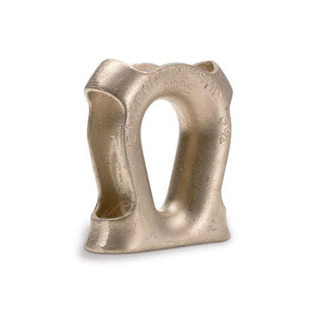

I'm minded that thare are numerous other factors in the mix to get right. One of them is the arrangement for securing the 'leader' end of the rode to the bridle arms. Thereare questions regarding what could be best practice, and what is clearly not. I recall that Susie Goodall was unable to be definitive regarding her equipment failure, but she seemed to think the failure was at the bridle/leader connection - or thereabouts.
Anyway, rummaging in one of my 'bins' this afternoon, I unearthed a number of these, intended for wire rope. I think they may be suitable for 12-strand Dyneema. My sources tell me that 10mm standard Dyneema is good for 13500kg, while 12mm will give 20000kg..... or rather more if the extra treatment is worth paying for.
Now, there are smarter examples of braced thimbles, and smarter prices, too, from the likes of Colligo Marine, Harken and others. That pair above still carries the price-label of £10....
