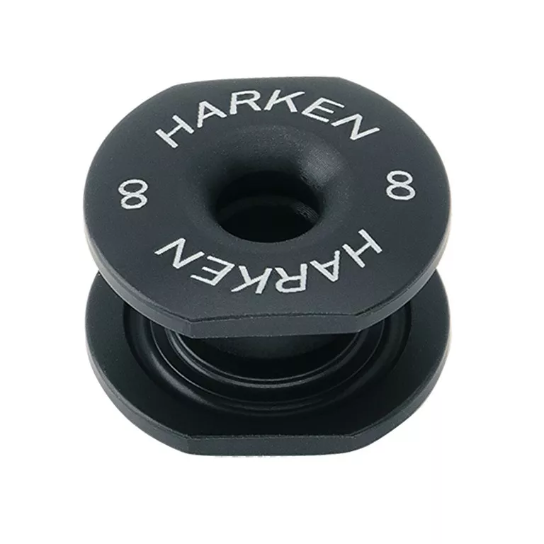

Laser310
15 Sep 2014
1,269
That would want to be 'flared'.... and it so happens that LIDL are selling some tube-flaring tools at present.
you can buy them from several of the hardware maufacturers
here they are on the US Harken site
