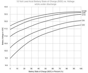

As a professional, you should know better than post #2 see below :
12V is 90% discharged.
The voltage under load is not a predictor of SOC without taking the factors I indicated into consideration.
I notice you tried to clear up the mistake in post #4 and correctly pointed out that this only applies to resting voltage, not the voltage under load that the OP was referring to.
Nevertheless, you did not mention other factors that make a difference, such as battery temperature. You also seemingly failed to grasp there is relationship between the voltage, SOC and discharge rate. See the useful graph below:
Below is a link you may find educational, but really you should already understand these basics of how lead acid batteries perform:
https://www.scubaengineer.com/documents/lead_acid_battery_charging_graphs.pdf
In post #13 you claim "A 660Ah lead-acid battery bank should not be regularly dropping below 12.0V with the loads you describe. The most likely cause would be a low battery state of charge, loads that are too high, a battery or batteries performing poorly, a wiring problem upstream of where the voltage is measured, or a combination of these factors."
Clearly not the case, as already explained, the terminal voltage returns to 13+V when the load is off. Only reason the Victron app shows a voltage of 12V is because the load is high. Bow thrusters routinely lower the terminal voltage to about 10.5V, doesn't mean any of your claims are true.
