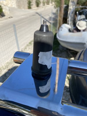

I have bought a RIB with a Garmin VHF 100i on board. The antenna is missing from its base.
Does anyone recognise the brand / type as I’d like to buy a new antenna to screw onto the base..
Many thanks

Without knowing the reactance of the coil, you can't calculate the correct length of whip. Probably easier to buy a new one, else you'll have to get an over long whip and use a VNA or similar to tune it by cutting bits off until channel 16 is low SWR.

Yes, but according to the Garmin website that's any Marine band with 50 ohm co-ax. Garmin don't sell a specific antenna and without knowing the make and model of the broken one you can't easily specify a new whip.

It wouldn't make sense to have a single antenna for a marine VHF as sailing yachts typically need a lower gain antenna than a powerboat.

Post 5 will get you there if you are practical and have a correct tools to create internal thread of right pitch etc etc
3dB gain as last post shows is best pattern for sailing boats because of heeling affect. Your rib won’t heel so much hopefully.

I think this is what you want. https://www.jaycar.com.au/475mm-stainless-steel-vhf-marine-antenna/p/DC2070 Most antenna use the same thread type for attachment. I am guessing that is what you need. Now the big bulb at the base as mentioned may contain coils etc to provide for a phantom ground plane and possibly coils to make the antenna a 3/4 wavelength. I am sure that rod will work but as aid you would need to check with a VSWR meter to confirm correct matching. I have used those rods with a plain base with a metal ground plane (the bars of the arch) with reasonable matching. ol'will
A whole new antenna can be bought for a little over £40 : VHF Antennas - Masthead, Stub, RIB & Whip Antennas
