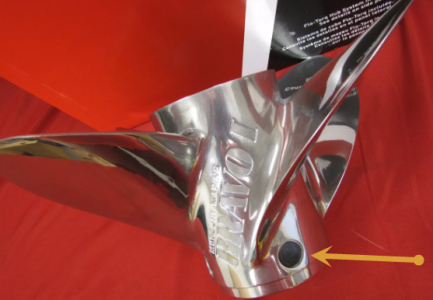

Thinking about which, Quicksilver's Performance Vent System® (PVS®) popped up in my memory. Does your prop have it?
When the rubber plug is removed, the holes vent exhaust around the outside of the prop, allowing the prop to spin up to an RPM in the motor's optimal power band more quickly. Otherwise, on some boats it feels like trying to get your car rolling from a dead stop using third gear.

Interesting ? - i will check but don't recall seeing a plug mine is mercury Bravo 1 not Quicksilver so may not be the same ?
It's all in the name. Mercruiser (inboard) and Mercury (outboard) shared many accessories and even made some for other makes. To support sales to non-Merc customers the more generic brand Quicksilver was used. I believe they tend to brand accessories aimed at Merc by their name now.
The benefit of PVS is that you can play with it and just put the plugs back in if not happy. If you (manage to) drill holes in your prop you won't have that option (drilling in these isn't easy!) unless you get it accurate and buy a set of OEM plugs
