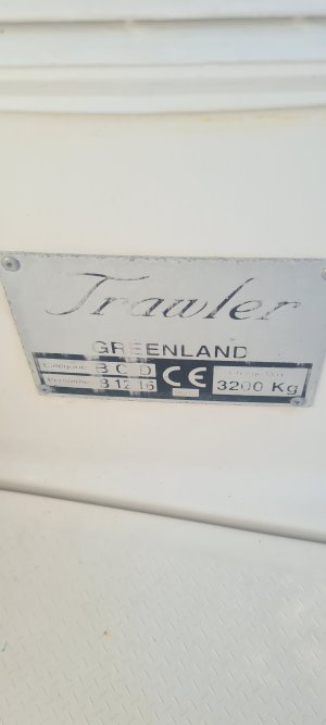

My boat has a CE mark which stipulates the max number of persons permitted depending on type of usage and I'm assuming exceeding that would invalidate my insurance and lead to possible criminal charges in the event of an accident.
That is based on the RCD and nothing to do with UK rules. However many European states such as Greece, Portugal, Spain do use it in that way. It was never intended for regulatory/commercial use as it is just based on a metric of displacement and stability. My Bavaria 37 I used for charter in Greece was licenced for 8 people. In the UK the MCA coding rules ignore the RCD and the maximum for the same boat would be 6.
The OP indicated he's talking about a pleasure rather than a commercial vessel. RCD not applying in the UK must be a recent development ;) and I'm sure it has been welcomed with open arms by British boaters :p.

The RCD does apply (or now its UK equivalent which is the same). The point about the people bit is that it is nothing to do with any legal status for carrying people. In the UK there are no legal constraints for private use. You could carry 25 people on your boat and not break any laws. I have not checked but suspect that in the countries I mentioned it would be illegal for private use to exceed the RCD limits, just as area of usage is determined by the category and which I know are used for commercial coding. The point I am making is that in the UK the RCD categories and capacity are not used at all as the MCA has its own rules for commercial use.
The RCD is part of consumer legislation (CE marking) intended to give guidance to buyers as to whether the product is suitable for their intended use, not for any regulatory purpose.
I take your point but I believe my earlier point is valid - I could have a problem with my insurance or worse if something goes wrong while I'm exceeding the limits for which my boat was intended and clearly marked.
