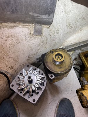

The two placed aside

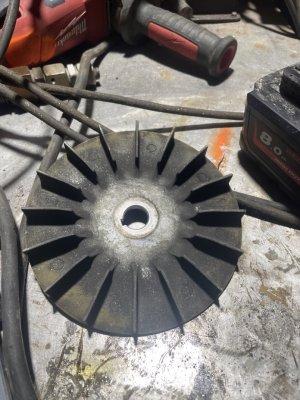

Old fan. Dirty, but all intact.

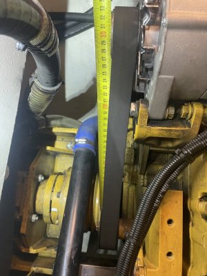

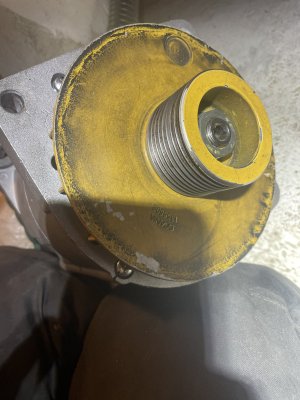

The reason behind current misalignment

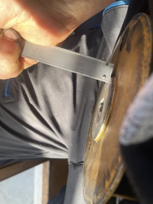

Distance between pulleys.
If it were mine I not accept that misalignment, I would shim the pulley to get it as close to perfect as I could measure. I would also use the cooling fan provided with the new alternator.

After talking to the vendor of the new alternator we decided it would be no problem moving over the fan from the old unit. Seems to work like a charm. No noise, charges very well!
Think i will clean and change brushes on the old one, keep it as a spare perhaps. It has only done 5400 hours, mostly running on idle speeds so there should be plenty left within it.
New alt, old fan.

Changing the alternator on a John Deere 4045 today. The new one should be indentical. Only more copper on windings, making it able to output 108A versus 65A on the stock one. Dealer fitted the new one with a Java Sea external regulator, to avoid the thing from burning up when I complete my LP battery bank which it will have to charge from time to time. Having put everything in place, I see(first I heard it) that there is a misalignment between the serpentine belt pulleys. Turns out thew alternator pulley is now recessed 2,5mm due to the old fan having a integrated shim that I failed to pay attention to when moving the pulley.
I now have the options to either put the old fan on the new alternator, or use new fan, and a washer. Does it matter what I do? How bad would it be to just leave it misaligned? The nearest pulley is 25cm away, edge to edge.
Are you making the assumption that the absence of the washer means that the alternator pully is now misaligned by the thickness of the washer? If so this is not necessarily true. You need to measure the two pulleys referenced to themselves or perhaps more simply referenced to the mounting face of the alternator as that is a fixed point that was common to both alternators and also to the crank pulley. Of course referencing the new pulley to the alternator mounting face only ensures that the pulley is back in the position it was in prior to the change and not that it was aligned correctly in the first place.
