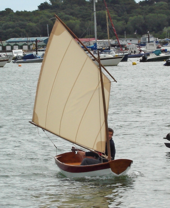

I built a couple of these about sixteen years ago - sold one and kept the other. Best dinghy I have ever used, fantastic fun to sail and rows and sculls perfectly. Like Vic's dinghy it is built from 8' sheets. It takes just as much effort and money to build something that looks like a bathtub as it does to build something that looks right, so I agree with the other posts who suggest getting a decent set of plans to work from.
This is the one I kept - by chance I re-discovered the other one hanging off a set of davits in Island Harbour last summer.

Thats a really lovely dink.
