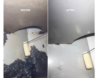

It could be a false economy not to have the tank properly cleaned. My tank (like yours around 30 years old) got shaken up in some rough weather and the gunk at the bottom of the tank was so thick it didn’t have a chance to get to the fuel filters. After two attempts at cleaning it was finally solved by having an inspection hole fitted and it cleaned properly. Well worth the money if you are somewhere you can get it done. See before and after pictures.
This is the only correct answer.
Bottles of snake oil and polishing systems are a waste of time and money.
