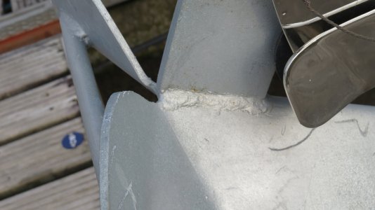

Some of the Delta copies are pretty dismal. This model called a "Shark" is one that I would be particularly wary of. Below is a photo of one slowly dragging with minimal engagement of the seabed. 6m @4:1. You can see the long drag mark and the puffs of sand indicating the anchor is still (very slowly) moving.
If contemplating a new anchor it may be time for a rethink. The Kobra is very slightly better for no more expense, or much better again is a range of more modern, non plow anchors with significantly better performance.

Some of the Delta copies are pretty dismal. This model called a "Shark" is one that I would be particularly wary of. Below is a photo of one slowly dragging with minimal engagement of the seabed. 6m @4:1. You can see the long drag mark and the puffs of sand indicating the anchor is still (slowly) moving.

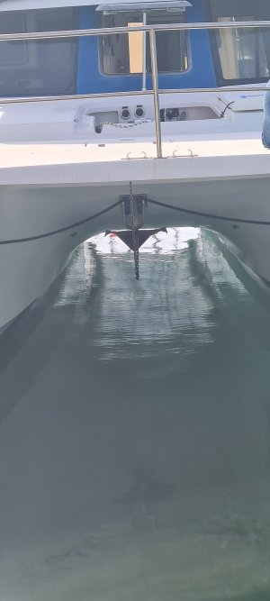

My cat is a Fountaine Pajot Greenland 34.
Buying abroad and bringing in my luggage is not an option - Turkish customs are a nightmare. If they stop you which they almost inevitably will, with a big lump of iron in your suitcase they will take great pleasure in making your life hell. It won't be just a case of show the invoice and pay the tax and the duty. They'll insist you appoint an official customs handling agent and will keep asking for paperwork until the hit on something you can't produce. It would be far cheaper, in the long run, to buy an Ultra, which are available here. I could wait until I go to Greece next summer, but I'd much rather not have to do that.
I notice you haven't expressed any opinion about the M2.

From your photograph I think it is unlikely that a roll bar anchor will fit. You can download templates from the manufacturer and create a cardboard or thin wood mock up to be sure, but I would not be hopeful.
Of the anchors you mention, the M2 is significantly better than the Delta. If you anchor out frequently I would spend the extra money.
The photograph is not ideal, but your existing anchor does not look like a Delta (or Delta copy) from the silhouette. Possibly a Spade? Can you post any better photographs?

Mea culpa. It is indeed a spade now that I googled the image. I don't know how i got it in my head it was a Delta.
