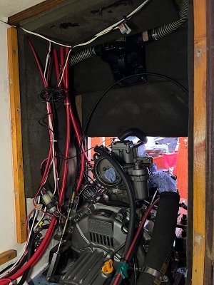

Every time I work on my engine I look at this area above the engine and think, what a waste of space on a 27f yacht.
I’m thinking of putting a board (with soundproofing) just above the engine and turning the area above into a battery compartment. I was wondering if I could get issues with heat or air to the engine if I make the engine area smaller? I’m just about to replace all the soundproofing so now is the time to do it.
I could fit a small odyssey battery in there easily, which would mean the current engine start battery could become another domestic, doubling the size of that bank.
Any thoughts?

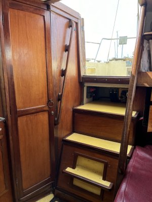

I'm guessing that's under and behind the companionway steps?
In a boat I had previously there was a sort of open shelf immediately below the companionway and above the engine - it was the top of the top step carried aftward, and with a space perhaps about 8" deep above it carried aftward under the bench at the front of the cockpit. (At the far end of the space there was a ply panel [missing in photo below] covering/protecting the back of the engine instrument/key start panel that was mounted at the lower front of the cockpit.)
This was the most amazingly useful space, and don't understand why every boat doesn't have similar. You could park things (binoculars or whatever) here and have them be readily accessible from both the cockpit and the cabin. Because of the side walls nothing would fall out, no matter how much the boat rolled. You could also place cups of tea or whatever here, out of the way of one's feet, but not in one's hands where they might spill or reduce one's ability to hold on while you were going up and down the steps, and could be retrieved once you'd arrived at whichever level you were going to.
I wonder whether something like this could be achieved from your under-used space over the engine? I'm almost certain you would find this much more useful than locker space freed up elsewhere by moving other kit into the space.
(In the case of my previous boat, the battery isolator and emergency link switches & VSR were mounted on the side of this space, and it was a bonus to be able to be able to reach these, too, from both cockpit and cabin.)

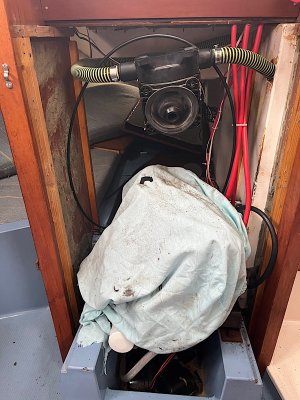

Well it’s been a busy day, took everything apart and removed all the old sound deadening.
Thanks for all the comments, I am having second thoughts about putting a battery up there. LittleSister, just out of shot at the top of the steps are my main switches, as you say it’s a perfect place for them. If I didn’t have the manual bilge pump located on the steps I would consider turning it into a locker.
I’ll keep thinking…
