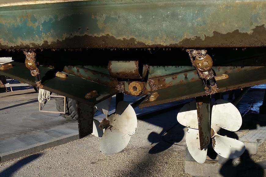

Before starting this short transfer, I expected to notice at least a bit of speed decrease through the usual rpm range, but if there was any degradation, it was negligible. In fact, after lifting the boat, I was pleasantly surprised to see that the props were pretty clean - see pic below.
I suppose they weren't equally clean at the beginning of the trip (I didn't have the guts to jump in the water to check... :rolleyes:), but if one hour at cruising speed was enough to clean them, it's reasonable to be happy with the performance of this Trilux 33 thing anyway, I reckon.

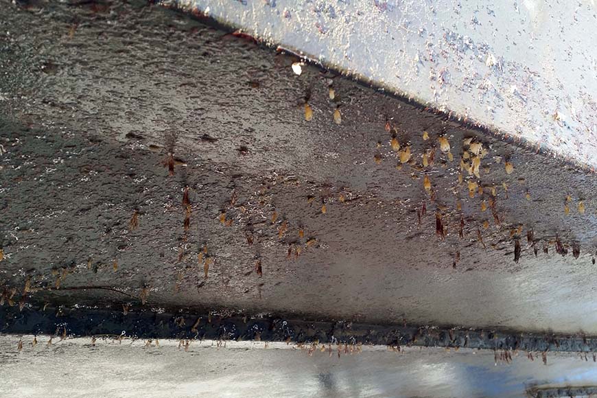

Otoh, as you can see, some growth managed to stick to the CC.
Actually, it wasn't as bad as it looks - in fact, it only took a rather light powerwash passage to bring back the hull to the greenish CC surface, which doesn't look worn out at all, also wherever some barnacles did stick to it.
Besides, several folks suggested in the past that CC is somewhat less effective on the first year of application, and performs better afterwards, so I guess I can't complain... Time will tell of course, but in the meantime I thought to post the experience, for anyone interested.
And for those already familiar with CC, I'd be curious to hear if they would consider this result in line with their own experience - TIA!
Props pretty impressive I must say .
I have never tried to do anything with mine on this boat .Previous boat nothing seemed to work ( no trilux ) on the SS prop set on outdrives.
It’s no hassle anyhow for me to scrub them , most boats just leave bare nibral or what ever .
So what’s next prop wise ? Is another layer of trilux just pasted on ? Year end on year ?
Good going on the props. I also had good success 2018 with paint on the props - velox in my case.
As you know and as I've said many times, I hate CC. I would never use it. Expensive ugly snake oil. Your pictures prove it. Micron 99 is far far better imho.

I didn't think about it yet. The boat will not go back in the water for a while, anyway.
IIRC, my local yard here used to apply Velox Plus on my old lady, which also worked well.
Otoh, life is bound to be much easier at 8kts for any prop a/f, I suppose...

Yup, I'm aware of that, and I don't even try arguing with the ugliness point, of course! :D
I'm just not bothered at all about it, but each to their own.
Ref. effectiveness, also leaving aside the possible improvement after the first year, actually CC did its job nicely for most of the season.
As I said, from Jun to Oct, while the boat has been regularly used, the hull stayed much cleaner that in the previous pics.
It seems that the growth mostly developed during the last three months of no use.
And while I'm a bit puzzled by that (considering also the cooler water), I was also impressed by how easily the slime was removed by the powerwash.
And in spite of the fact that several barnacles managed to stick to the hull, once removed by the powerwash it was impossible to understand where they were attached - just to give an idea of how intact the epoxy surface remained, underneath (sorry, I didn't take any post-powerwash pics).
In other words, I'm rather confident that the hull is now already good to go for the next season - in fact, I could have put her back in the water right away if I wanted/needed to, which can be in itself a bonus for some people.
And if that will still be true for the next 5 or 6 years (let alone if it would last more), well, that's a snake oil I can live with. :rolleyes:
Btw, even accepting (and I half recall some pics which you posted) that Micron is more effective, as I said previously the boat performance didn't seem to suffer in a perceivable way, even with the above dirty-ish hull.
I would think that this has something to see with the fact that the growth was mostly just thin slime, but now I'm just speculating.
Chatting with a professional GRP man recently he reckoned most appliers of CC do not spend nearly enough time abrading the newly applied coating, so too much of the copper is left with a minute coating of resin, which is why it reportedly improves after the first season.
