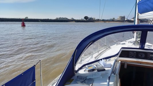

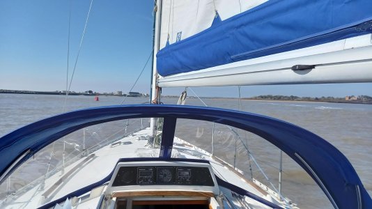

Now that my Moody 31 is launched (drawing 1.6m), I took a trip through the Deben entrance at half tide on Friday in calm conditions to see what's what. My friend also took his Starlight 36 through at HW today and we compared our findings.
We both found that the shoal section between the inshore Deben SH buoy and the Knoll Spit PH buoy is the shallowest section. This is where the river splits into two channels, one going via the shore (last year's entrance channel) and the other out to the South East, the new entrance channel. The bar itself by the Mid Knoll SH buoy seems to be just that bit deeper.
For me at half tide, the outer shoals were just showing (see below) so for people coming in a a couple of hours before HW, they are likely to be covered. The West Knoll PH buoy is to the left of the mast.
The depth coming in was fine from the outer Mid Knoll SH buoy to the West Knoll PH buoy (above) then it reduced to the minimum just between the last two Deben SH and the Knoll Spit buoys.
Photo below is the Knoll Spit PH buoy at near the shallowest section.
We both kept to the middle of the channel which is quite narrow at times. We also noticed how the depth wasn't so good if we started exploring from side to side. We kept away from the Knoll Spit PH buoy above as we are fairly sure the buoy sinker is sitting on the spit and that could be a real keel cruncher when the tide is down.
As our yachts sometimes need to get out of the river as early as possible, then the more information we can get the better. Please don't take this as advice as this is best left to the experts, and I have only done it once, but you can get an idea from the photos what you will see when coming into the Deben.
