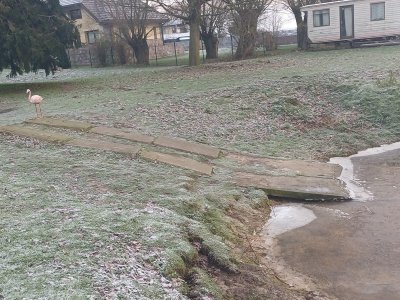

Decided to risk her staying in for a few more days .... temps are in the 0 .. -5C range ... so ice will increase - its about 5mm ~ at present ..
Job now is sorting my slipway and get boat out at there at home ...
As you see - its not straight angle .. trailer bottoms out at top and mid section ...
Using HIAB and my Mini Excavator - we started by moving the top 6 small concrete blocks then digging out the undersoil ... excavator decided to blow a hose !!
Will be back on job tomorrow.
