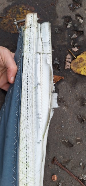

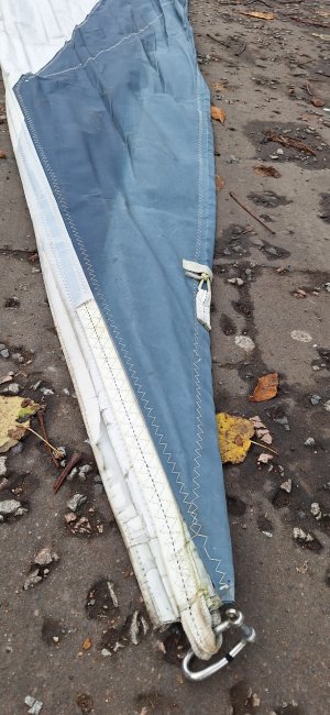

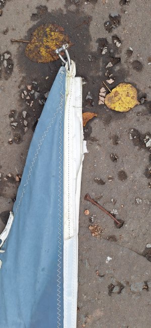

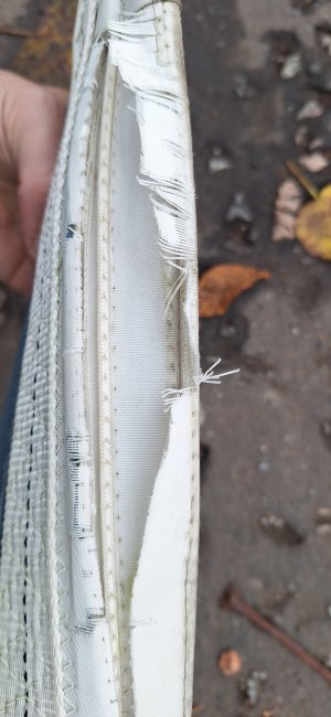

Hi, after some advice again please. I have some damage to my headsail as you can see in the photos. The sail material feels quite weak/brittle if you know what I mean. Do I just give the sail to a sailmaker to repair or is this something I should try and repair myself ? The rest of the sail seems okay but i am sure a trained eye may tell me otherwise. I don't know anything about sails or sail repairs.
The sails is old - 2007. A new one would cost roughly £1500 (from Hyde sails).
Thanks

If not mistaken .. damage is on the luff where it slides in the furler .... I would be looking at the furler as well .. see if any rough edges / damage ..
Problem here if you try repair yourself - keeping repair still able to enter furler ..

Seems to me it is UV damage. Of course it can be repaired. Whether you can do it depends on your skills. You are going to have to buy the right material as well. I think the rest of the sail needs critical assessment. Personally I would be taking it to the sailmaker and I am sure they would give you a quote and an opinion. I would trust our locals for an honest opinion.

It’s not an expensive repair ,but to do it properly I would remove the webbing and Replace a short section of tape with a diagonal join so it wouldn’t be to lumpy on the joints.
You could alternatively trim it back down beside the webbing .Stopping a few cm before the end of the strap. .The head of the sail is held against the foil with the swivel , so there should not be much load at that point.

The cause is far too common. The UV protection at the head of the sail does not include some of the tape and the webbing at the head. My current jib is very good that way, but with others, the smart solution was to paint the few small exposed areas with with two coats of a flexible vinyl paint, such as used on inflatables, but if that is not available, even house paint. Very easy, completely invisible, and prevents repairs like this 5 years down the line. Just a little permanent sunscreen for where the cover missed.
This can also apply to mainsails. Any bits the cover does not cover, often just a little webbing an a few inches of leach. It's a big help.

Basically if you can tear it easily or the stitching pulls apart it’s dead .
For the OP ,the head of the sail should have had the strip covering the strip of exposed luff tape, this can be done easily to conceal the repair .
The rest of the luff tape has probably been protected with the sac strip rolled over it .
