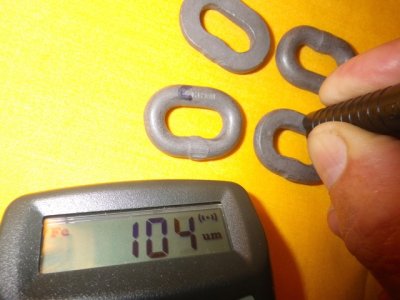

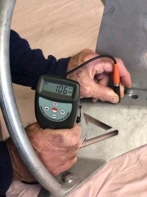

My galvanising thickness meter is not sophisticated and the chains in which I am involved are coated to a 100 micron galvanised thickness (most chain is HDG to 70 microns but variable, the US Navy spec is 80 microns). I have to measure the thickness but I need to measure a flat surface. Links don't have flat surfaces. The answer has been to slice the links length ways - as you might slice a donut. This means cutting out one link, holding it in a vice with one crown sticking out the top, slicing half of the link and then turning the link upside down to slice in the other direction. The cut links, they are whole - but halved, are then wired down the length of the rode, maybe every 10m. The cut links are then measured for gal thickness. Labour intensive - but it works. Its easy for me to measure gal thickness on a flat surface, like an anchor, but not a tight curve, like a 6mm chain link. When I started I ground the cut surface flat, as in the photo, but now I don't bother
