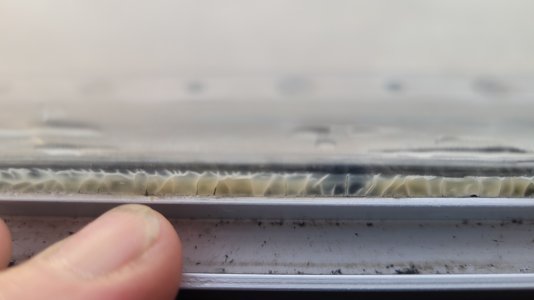

I have used the clear CT1 to try and re-seal leaking window frames on a Moody boat on 2 occasions, on both the inside and outside.
Both times the adhesive went soft, yellowed and has cracked. It became very soft and almost waxlike and could be easily removed with my finger nail. Its a shame as it was easy to apply and wipe off the excess. See attached photos from inside the window. The outside was the same. I dont know why it has failed in only a few months, perhaps its alergic to sea water? Has anyone found success in a salt water application that has lasted more than a 3 months?
I have resealed them now with white/black Sikaflex 29120241021_172815.jpg20241021_172819.jpg20241021_172841.jpg
