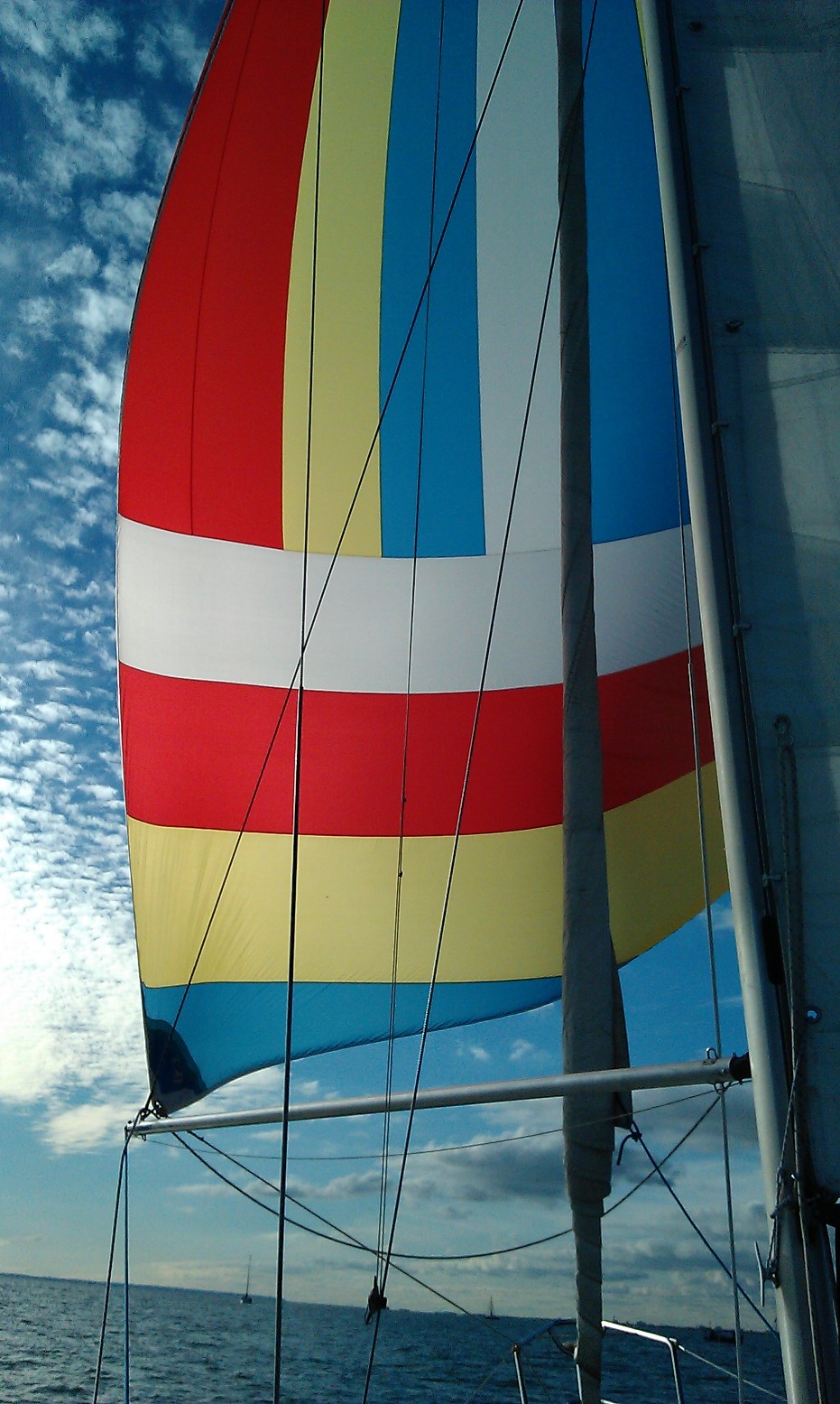

But... You said you had a spinnaker pole.... The best way to get downwind with a cruising chute is to pole the tack back with the spinnaker pole. Keep the pole quite low, and keep tension with the tackline, but this really does work very well.

Bit confused by this Flaming, can you expand on it a bit?
DJE, is that the tack or clew pole is attached to?
Edit: I see now, it’s the tack. Cheers for pic, very interesting technique.

If I tried to do that the pole would be just above the guard rail because I have a fairly big roach in the luff. I assume that you have a fairly straight luff or it is fairly short to start with. Mine is set with the tack just below the pulpit & I can ease it off about 3 feet. But then the luff is very round.
As I recall the pole is attached to the Guy or clew as for a spinnaker. Tighten and slacken the tack line to raise or lower to trim, as already mentioned lowering the tack tightens the luff; the the trimming is as for a spinnaker - a slight curling to the luff the closest she goes . slackening the tack line will cause the sail to lift the bow as the sail does fill more fully.
