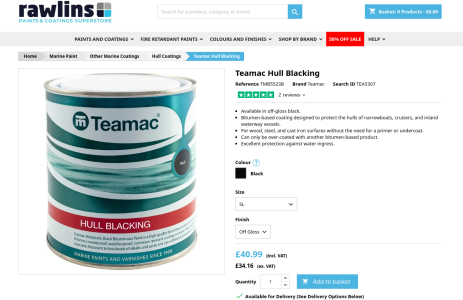

Maybe this but not sure its all that good at antifouling
Or something cheaper but equally uncertain on antifouling capability1733605719725.png

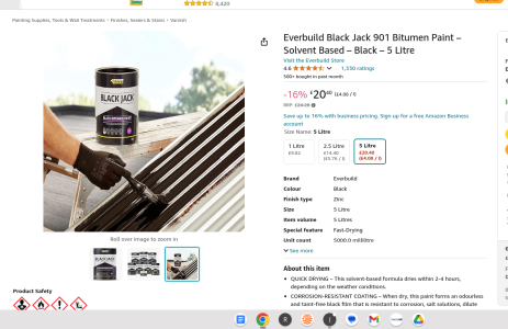

Or something cheaper but equally uncertain on antifouling capabilityView attachment 186484
No reason to believe its anything like toxic enough.
But I suppose one could overcoat it with creosote, if you could get or make some
Or mix creosote in to it.
Or mix a lot of copper powder in to it, (if you could get some) to make a poor mans coppercoat
It probably wouldn't be ablative though, so you might have to scrub it to activate, which is alleged to be the case with epoxy-bound coppercoat too.
A potentially huge advantage of these bitumen-based paints (assuming they havn't changed the formulation from when I last used some on a boat trailer several decades ago) is that they remain dissolvable in white spirit, gasoline etc after drying. This means they can be "revitalised" on the job or in the pot (=infinite pot-life, AFAIK) and can be removed with relatively low effort.
