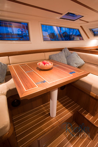

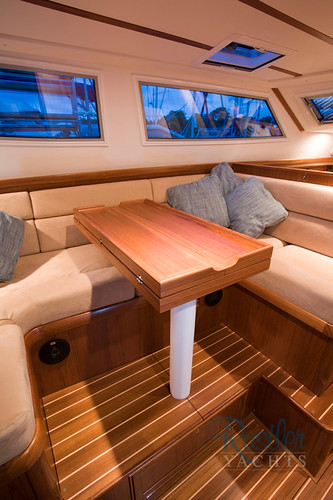

Looks like I don't need to - Ex-SolentBoy's picture shows exactly the principle that mine uses. My fiddles are higher (when the table is closed it's almost a shallow "feeding box" rather than a table) so the support is even firmer, but the layout is otherwise very similar. I have the same "dropped kerb" fiddle cutout at the end so that the under-table supports don't conflict with your knees; mine is on an athwartships side so nothing can fall out through it when heeled though.
As I said, my tabletop is completely solid when open, as I'm sure the Rustler table pictured is. Sadly, what I hadn't anticipated is that the mounting of the whole table to the compression post isn't as stiff as it really needs to be (it hinges there as well - small boat needs adaptable space) so it still tilts a little if you lean on the edge :(

Well PRV and SailorBelgianBeerDrinkerMan have said it all really coupled with ExSBoys clear pics...
