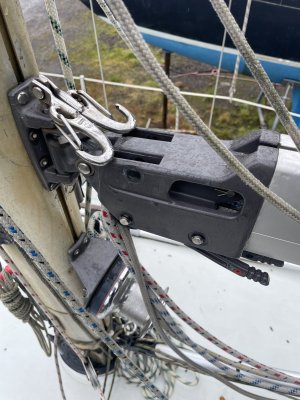

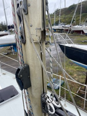

Hi,
Ive decided I would like to change the reefing set up I have on my boat. Currently its slab reefed. I wish to change it to single line reefing. When the mast comes out I intend to fit a new mast ring. I am going to use the existing boom with the reefing lines running thru it but exiting thru the top of the boom. Ill refit the pulleys for two reefing lines only.
Now the little problem. My mainsail has sliders. Annoyingly the mast track has around a foot missing above the boom. I suspect the track was originally for a bolt rope. the sliders work fine, but when I put a reef in the sliders come out the track and causes a little untidiness. Not too difficult to deal with it your at the mast but I dont want to be. I wish to be able to lower the main. add a reef from the cockpit.
So im wondering if there is a way round this problem. I need to add a track below the bolt rope track. with a gate I can open to install the sliders. ive considered altering the main to bolt rope but id still get a loose main below the reefing point when I drop this. so I dont really see that a resolution. I wondered with all the expertise here you may have some ideas other than changing the whole mast track.
Thanks

My first reaction was to fit one of these tidesmarine.com/pdf/sailtrack/sailtrack_catalog.pdf as I have just done. The only slight reservation I have is that as it fits into the existing track you will need a spacer between the bottom of the and a piece of plain track to support the lower part of the new track. Don't think I have seen a mast like that with the track extrusion rivetted on. On the normal Proctor spar the track is part of the main extrusion and the lower slot is the same level as the bottom of the track.
If you can fit it the new track makes raising, reefing and dropping so much easier because of the lack of friction. so far the best bit of kit I have added to the rig.
If you can find some track which takes the same sliders, someone could splice that onto the existing, you'd have to fabricate spacers to line it up. You might weld the old and new track together, or just butt it and reinforce.
I think there are various sizes of track for T sliders, but there's some on ebay from dinghy jib tracks.

Hi Tranona,
Thanks for this. What you are proposing is I mount a new track on the existing one. id not considered that option. I suspect It was normal to have a gap to aid the rope feeding in to the groove when raising the mainsail. It must have proved a little difficult lowering the sail though and indeed when reefing even if your at the mast.
Probably the easiest option is to replace the mast but im not sure thats an option this year. If I could find the same track then as B27 suggests i may be able to get someone to splice it on. I suppose I could fit the sliders at the very bottom of the track and do away with the need to create a gate. The sail does need to drop as low as possible though. Not sure how this is achieved fully on other boats given most sails have a dozen if not more sliders. all food for thought.

I would suggest forget single line reefing. Try 2 line on your first reef. I presume here you have to hook the tack over a horn to attach the reef tack eyelet. Just fit a line from a point on the mast below and ahead of gooseneck that goes up through the reef tack eyelet and back down to a saddle or sheave mounted again forward and below gooseneck then down to a turning block back to cockpit. Yes slugs will fall out but at least you will be able to reef (one) from cockpit on run.
Yes perhaps fill in lost track as in other post. Make it easier for stowage of main sail anyway. (you will need shaped cover for main sail) The tack reefing line should pull the tack eyelet at 45 degrees forward and down to pull eyelet forward in line with mast track so no load on slugs. ol'will
You may find that you do not have to alter the mast at all. Just remove the sliders on the sail nearest the reef cringle (Just remove them from the track to experiment at first). This will allow you to pull a fold of the sail down past the rest of the sail stack. You will not get right down to the gooseneck, but may not have to. Fit some spectacles through the reef cringle . (2 rings, a dynema soft shackle through the cringle such that the rings do not pull through) You will have to experiment with some cord & vary the length first to get it set up whilst the sail is down. Then fit a free running pulley to one of the rings, such that when the sail is in the reefed position the pulley is somewhere above the gooseneck.
Your single line can now come up through the boom, through the pulley, down through a guide on the mast (to keep it forward) & down to the deck
Once you have decided on the right positions etc you can refit the sail sliders to the optimum positions
Remember, the closer the sail is to the gooseneck the less it will pull aft when you reef, which is something to be avoided
