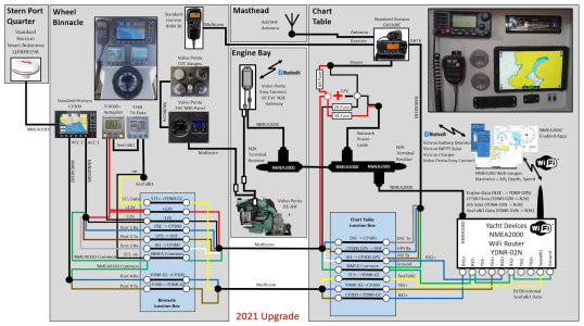

Please go easy on me - I can do most things on board but NMEA isn't one of them !. I have ST60 wind and ST40 depth and speed, all going to displays in the cockpit. Old, but it works. How could I connect them into an NMEA 2000 backbone ?.

The converter kit from post #2 is a good start, but we need to know what N2K kit you have and do you already have a N2K backbone/network.

I think Paul's link may have been to a "sister" product which provides a USB link. There is a ST1 - Wifi product from the same company for < £100. It will output all the data fed to it from ST1 on one Wifi "stream". Which App do you intend to use on the iPad? Orca would work nicely if you use the Orca app but perhaps not with others? It would however add GPS, compass etc to the mix being sent to the ipad which may or may not be helpful. It will also open up the possibility to interface with an autopilot.
But I'd start with a sheet of paper and work out what you want a bit like a simplified version of Baggy's drawing above. ST1-STNG is possible but don't fall into the trap of thinking its just one cable. STNG-N2K (NMEA2000) are essentially the same electronics standards so its physical connectors that are different (so is relatively easy). But this is probably the time to be thinking about what the future looks like - spending £100 now but having no future expansion might be a PITA.
You're correct, apologies to CPD, i linked to the wrong version.
Try this : ST1toWiFi

Sorry i linked to the wrong version, see : ST1toWiFi
Should send all of your Seatalk data over wifi.
Well worth following the suggestion from ylop to consider what you may do in the future, before committing to buy anything now.

On my boat I have the VelaNavega NMEA2 converter, Nmea2Wifi, which takes the NMEA data from my Ray ST60 network and makes it available on WiFi for Navionics running on my iPad and Android
