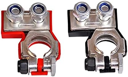

Any use?
https://www.amazon.co.uk/Cyancld-Terminals-Positive-Motorcycle-Connectors/dp/B091J24DXX

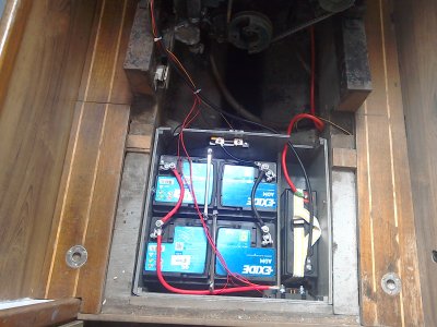

I used the terminals in post#3 and made up the cables with the correct lugs to suit the studs. You can see them on my house bank, but my start battery has M6 set screws so again I made the cables to suit. B2B not connected in this photo but has 6mm lugs on the cables like the main one to the starter.

In an ideal World, fit one of the clamps in post #3, make a cable to go from that to a busbar, then connect all positive cables to the busbar.
Next best, if the length of the alternator permits, cut the cable and crimp lugs onto both ends, connect the lugs to a busbar, then add any other positives.
Lastly, fit the terminal from post #3 and crimp a lug on the the alternator cable. This is acceptable as long as those are the only two cables on the post, it's not good to have so many cables connected to the battery terminals that they look like hedgehogs ;)
No negative connection between the engine and domestic batteries ? Or work in progress ?
Tranona
10 Nov 2007
42,834
Work in progress. Just temporary at that point to get the engine running so that I could demonstrate it to potential buyers. Negatives go to a bus bar. I used that photo because it illustrated what I think the OP needed to know about how to use the stud terminals.
