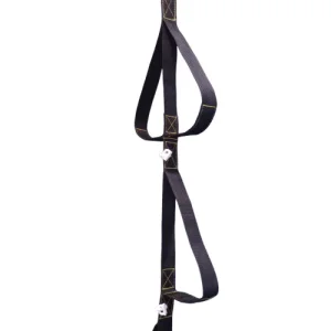

I always used a mast ladder. They go into the main track and you can pull them up. Made of webbing with loops left and right to climb up. Run a prussik knot along with you on the main halyard (tie it to something at the base to put some tension on it), and clink into the safety on the prussik. Bring a bosuns chair, too for comfort.
Prussik knots slide up and down easily if they're not under tension, but as soon as you fall, they catch you.
