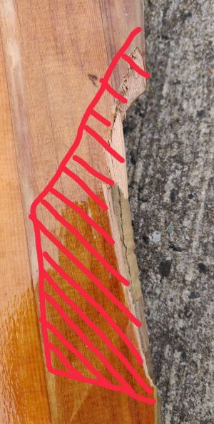

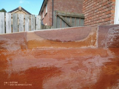

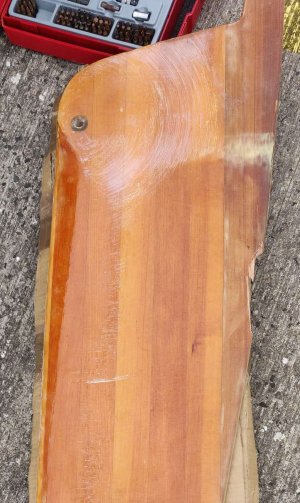

Hi guys,
I was recently out in my Phantom dinghy in blustery conditions and in the process of a dry capsize it appears that I have stood on the trailing edge of my wooden centerboard and a piece has splintered off it
I have little knowledge of repairing foils but from asking around the accepted wisdom appears to be to grind out the highlighted section (which is where I can see signs of damage) and rebuild it using epoxy.
The trailing edge is very thin so I'm thinking it would be necessary to go quite far back into the wood so that the epoxy has something to bond to, I would also need something to keep the epoxy in place while it cures, maybe a pair of steel rules and some clamps, or maybe glass fibre tape?
Once cured I would have to sand the epoxy back and finish it and any of the affected wood which would probably require two pack varnish?
I'm having a little bit of trouble finding guides to doing such repairs, possibility approaching this as a novice, would anyone be able to provide some pointers to good guides or even just provide some pointers as to how they would approach such a repair?

I'm not sure I would rush to grinding followed by lots of epoxy on a wooden keel that is already made from multiple strips glued together. If you saw and chisel out the affected area you should be able to remove it neatly. Then cut a new bit of the same wood to a bit larger than required, making sure the grain aligns the same way and that there are suitable flat patches to clamp it down by when gluing (you can curve them later). Cut very slightly large and use a very sharp chisel to pare down any unevenness on either side so it is a perfect fit. Epoxy glue it in (lots of clamping), then chisel, plane and finally sand it down to the right profile. Then sand back a little of the existing varnish on the original part, give the whole area the same varnish treatment as the rest of the keel and you can hardly tell it was repaired. I've done this very successfully on a rather similar wooden centreboard, though not quite such a big bit of damage. It wasn't particularly difficult.

Just cut it down one of the lines visible where two bits of wood are already glued together. That should be a good bit back from the trailing edge so you will have more thickness to work with. Get a plank large enough to replace the broken bit and a bit more. Use biscuits, dowels, or tongue and groove to joint them (whatever is easiest with the tools you have) with good waterproof glue and clamping overnight. Then, as wood is easy to work with, remove the excess until you have your desired shape. You can use the old bit to develop a jig for planing or sanding. Varnish and jobs a good un

I think you've got the right idea of what to cut out with your red lines, but that foil looks to be solid timber, so I'd be inclined to repair it by scarfing in a new piece. Use thickened epoxy to glue everything, shape it then cover with a layer of fibreglass cloth.
Loads of videos on scarf joints on You Tube, and more than you'll ever want to know about working with GRP in a book you can download here

I have repaired laminated oar blade edges that are very thin. I wouldn't remove anything more than necessary.. Doesn't matter how thin, the glue should be as strong as the wood.
I suggest cut the damage out with two straight cuts, then bring in a piece of thicker wood and cut as good as you can, clamp in place not too tight and run a fine saw along the joins, repeat until you have a perfect fit. Glue, clamp, finish.
The new piece can be lots bigger than needed or you can screw it to a piece of gash or between two pieces so you can get a grip, and get clamped better. Cut the edge profile when fixed.
edit: sometimes your instinct is to get a thin piece of wood and try to clamp the thin edges together. I get a thick piece, and clamp like the top of a 'T'.

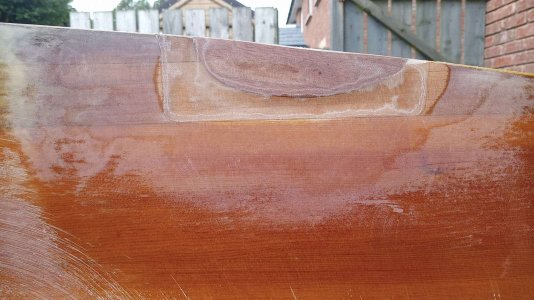

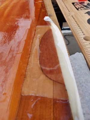

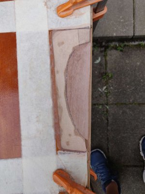

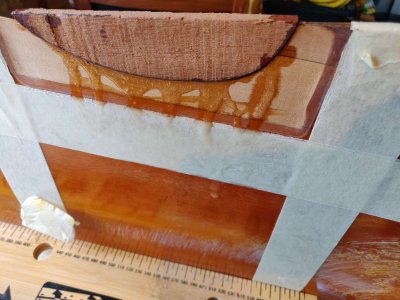

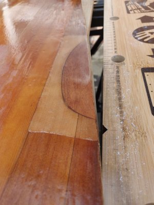

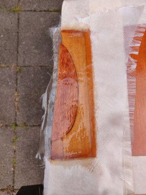

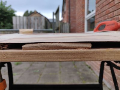

I wound up able to have a word with Alastair Duffin who was kind enough to provide some tips, plus a scrap piece of wood from his workshop!
Had a go at repairing the damage myself in preparation for the nationals after picking up a mouse sander, some general purpose sand paper (+ block), a fibreglass repair kit and some epoxy.
I wound up cutting out the damage with a coping saw.
Think it's went ok for a first attempt.
