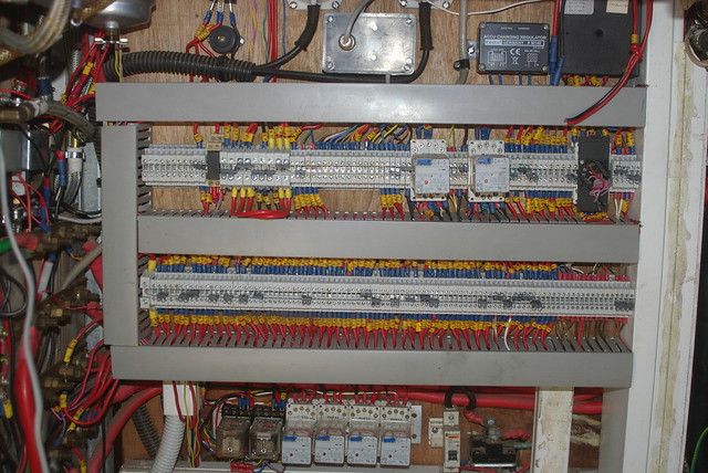

I don't, I strip back the wire, fold the stripped wire back over the sleeve and put that into the terminal block with the sleeve side up to the screw, then screw down onto the sleeve.
PS Makes for a good electrical and mechanical anti-vibration connection.
I used to do it that way but I use a variation where I push the cable right through to the other side of the block so that both screws are gripping bare wire + the insulation from the other cable.
I've never heard of anyone else doing it this way .... but that's situation normal on the forums.
