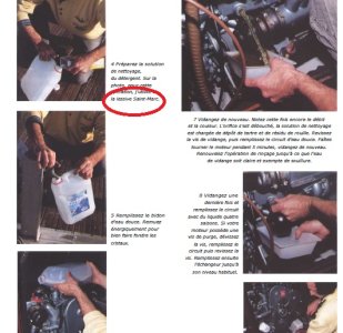

I am thinking of washing soda because I don't want anything too aggressive attacking the copper heat exchanger.
Any thoughts or advice?
Fwiw, here in France it's common practice for that purpose to use a cheap commercial product named "lessive st marc", non-foaming detergent whose main active component is sodium carbonate deca-hydrated which I just discovered is also "washing soda"; maybe not chemistry Nobel prize but surely it's efficient and -given its widespread diffusion- no ill effects are known. One engine maintenance book says to drain coolant, fill with solution with product above, run engine under load for about 10-15 min, drain etc and repeat until the solution comes out clear. Rince a few times with fresh water, drain and fill with new coolant.
This post relates to vehicles, but to some extent boats too.
People do all sorts of things, but flushing with washing soda is a monumentally bad idea for vehicles with aluminum radiators. So bad you can Google it.
A weak, inhibited citric acid solution, generally with some EDTA is the standard method and has been for decades. You are trying to remove lime and other metal hydroxides, so a weak acid is what you want. Lactic and citric are least damaging to aluminum. Oxalic acid is also used. If you want to use an alkaline flush (no good reason to IMO), then look for borate. It is less corrosive and more effective, and is, in fact, part of the additive package of some inorganic coolants.
No doubt that product is cheap. It will clean some gook, but it won't descale and it can corrode metals.
https://beta.lakeland.edu/AboutUs/MSDS/PDFs/3266/Super Flush Radiator Flush (Prestone) 10-21-16.pdf
https://clrbrands.com/CLR/media/PDF...-Radiator-Flush-Cleaner-SDS-16-Jan-2024_1.pdf
https://clrbrands.com/CLR/media/PDF...uty-Radiator-Flush-and-Cleaner-SDS-2-1-22.pdf
https://www.crcindustries.com/media/msdsen/msds_en-1006067.pdf
Just relating a very common practice, all possibly exceptionally wrong, except that practice has shown no ill effects, anyway whatever people do or don't on their engines is up to them. No idea about aluminium radiators (and google), it's usually an alloy with more diligent owners.
A friend of mine uses a dozen different chemical products to fit seacocks to grp (several different types of sealants, primers, washing agents, degreasing agents, etc), given his specific industrial background I am sure it represents the state of the art in seacock fitting. Why not, though maybe 99.9% of seacocks are fitted using one cleaning agent, some Sika sealant and job done.
I think the fallacy is obvious.
a. Many people smoke cigarettes without ill effect. doing something wrong does not always have obvious,i mediate consequences.
b. Most people never flush a radiator, probably with even less ill effect. That is what the industry has concluded.
Notice that the coolant manufacturers don't make flushing chemicals. That should be a big hint. Mostly, they are all bad, should only be used when required, and don't DIY the chemistry.
Something to consider. Coolants work, in a way, like anodizing aluminum. They create passive films. When you use a flushing chemical you corrode the film away, and the coolant has to passivate it all over again. One of the main problems with changing coolant types is that they form different films. Sometimes, in the process of replacing the original film with the new film, a strip or spot of no-film (active metal) is created and pitting starts. I'm retired, but I will still tell you that switching types is almost always a pointless risk with no upside.
Or smoke cigarettes because all the cool kids do. The doctors don't know a thing.
