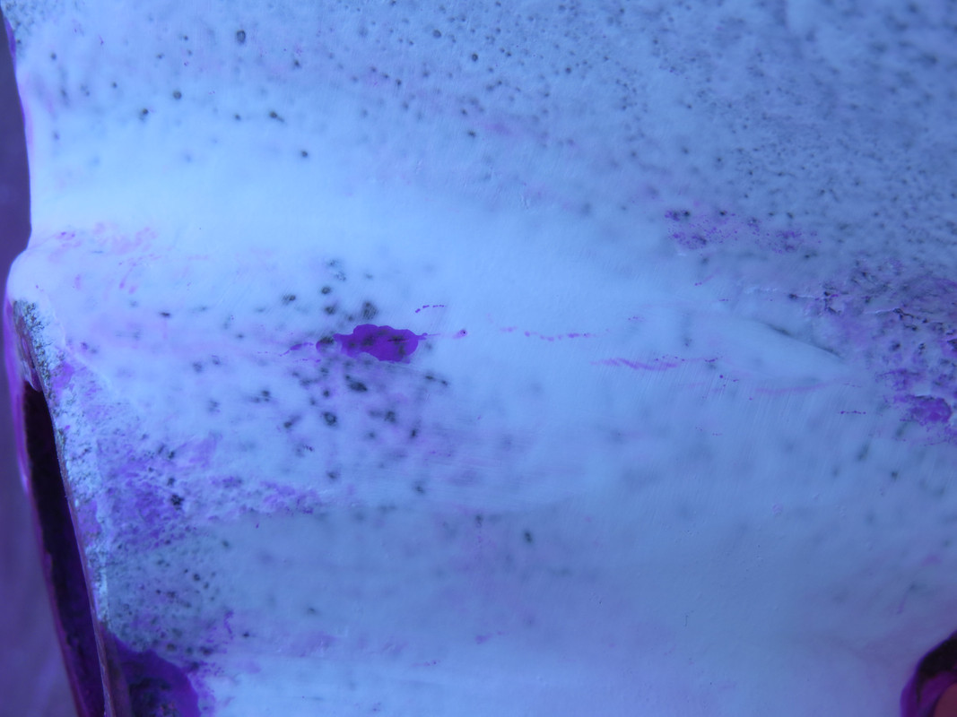

I wrote a piece on crack detection for PBO a few years ago. I owned several items with visible cracks but of course it was difficult for me to happen upon something thought to be sound but actually cracked. One of the items I did have was a propeller with three sets of cracks in the hub between all blades. Although the larger crack at the left shown in the pic was visible by eye I had not seen the fine one revealed by the dye penetrant.
