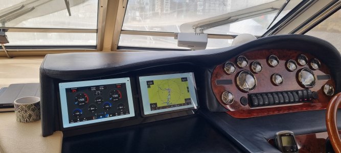

How about, Garmin GPSMAP on the flybridge, a Seatalk to STNG converter, with a STNG converter cable to the plotter. Gives you a new plotter (N2K) but you still retain all of the older Raymarine kit, with data sent to the plotter. Fit an Android tablet at the lower helm, which, with the Garmin Active Captain app can be used as a stand alone plotter, or it can mirror the GPSMAP by WIFI. You can get a new 10.4" tablet for £120
Here's my lower helm, with 2 tablets, mirroring a GPSMAP 1223xsv and a GPSMAP 923 on the flybridge:

That looks very impressive Paul. Certainly some food for thought with that setup. I'm pretty handy (it was my job for a long time) with networking and computer related malarkey so this does appeal to my slightly nerdy streak. :cool:
Note the tablet on the left is showing engine data, that's not necessary at the lower helm, as there are analogue gauges there, but the boat (1988 P45) only had tachos and warning lights on the flybridge. So i fitted an Actisense EMU-1 and connected the engine sensors to it, putting the data on the N2K network. Also fitted the Garmin N2K converter for the Bennett trim tabs. Pretty cool for older TAMD71 engines i think ;)

I agree that is pretty cool. Give a very contemporary look. I know with my CATs, though I've already got digital displays, I can do the J1939 output and broadcast all kinds of funky info onto a tablet. I may do that since the CAT digital displays aren't the most visible.. Lots of scope to try something new..
The GPSMAP 1223 (and lots of others) has a J1939 port.
