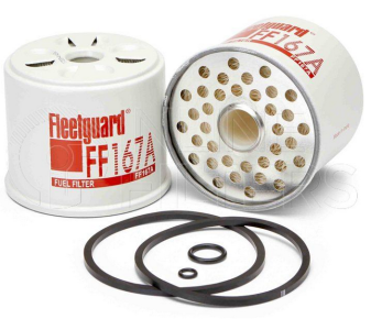

As to issues with cartridges, I have used a number of Fleetguard FF167A without any problem, then there was the odd one.
The paint flaking on the underside is in the "clean" side of fuel, from there it goes up through the center hole then straight to the engine, if flakes aren't so big to block the filter head outlet.

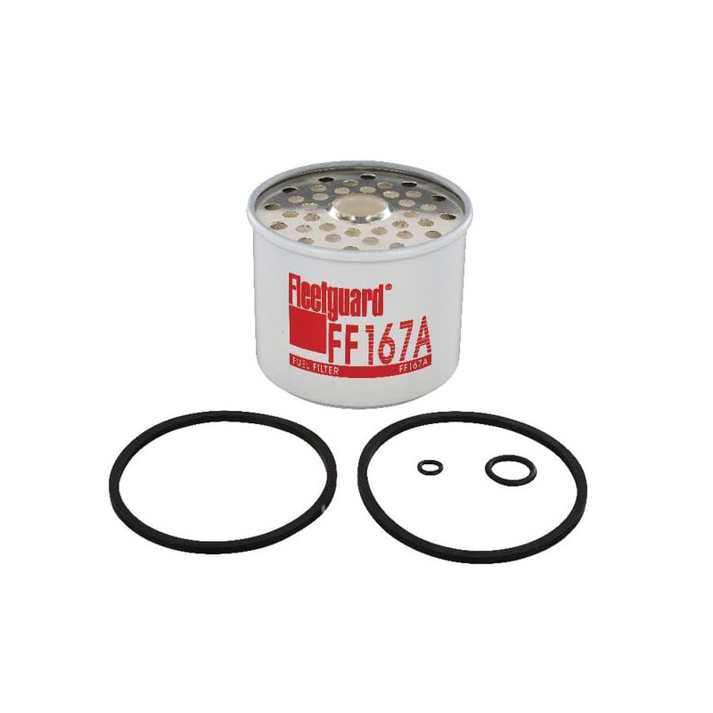

Strange that the printing on your filter is upside down when compared with this photo from the Fleetguard website.
I don't have one on hand, maybe they print the label upside down on the two sides (?), and the adverts show it the visual "right side" up? The side hidden in the picture is not white, there is only a tiny blank spot around the cartridge to mark the date and engine hours :)
Google Image "fleetguard FF167A" shows them printed both ways.
add
there are also several different graphics: big/small fonts, red rectangle or not, etc

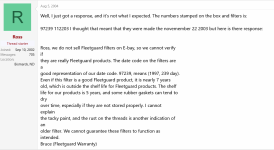

Scratching around on the internet I found this:
counterfeit fleetguard oil filters?
Freebee
21 Oct 2001
2,264
Alton, hants
i worked in the automotive filter business in the predecessor of Delphi for 16 years in Engineering, even in those days (50 years ago) our agents would send us counterfeit look alikeees of our filters made in the east and labelled as our products, sold in europe. it was all too common, on one notable occasion somebody bought our scrap pile and sold it on markets as our genuine products, we knew it was our scrap because there were totally empty cans with no pleats inside, they had been put together by our engineers who were setting up the machinery for production runs-needless to say we bought a scrap bailer after that..

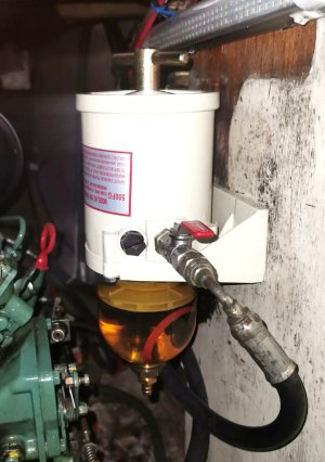

Mmmm no the 8gph would be in US units as it was their tech people that generated that level not me.....and I would assume that they have taken the points you raised and others beside in coming to their recommendation. What they won't have factored in is poor location and / or lack of practical ability as and when maintenance is / was required. They do point out the possible need for providing the 500 with a head etc ( in my postulated application) that most won't be able to achieve.......
racortech <racortech@parker.com>​
5 Jan 2022, 14:21
to me
Hi Ian,
The best scenario for using the 500 unit, in your application, would be to have the tank above the filter providing head pressure.
Kind regards,
This before they go on to recommend those assemblies listed above as being more in keeping for my application, even when told that I intend to fit a high level day tank too......
I take from this that 'biggest' though eminently functional if expensive etc is not always best and the 'normal' can be equally as good........in most applications.
