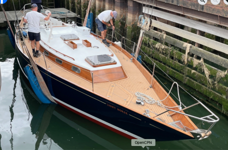

dom
17 Dec 2003
7,145
35 years in the same ownership is quite a recommendation!
The value or otherwise of this vessel turns on two intriguing sentences: :)
"Offered at € 160.000, she is ready for some minor works to put her back in original shape.
Alternatively, a complete refit converting her into a mini-J-CLASS could be considered."
