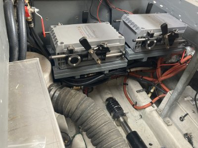

Well we replaced our Morse controls with electronic last winter. Cost almost kyboshed the idea but was offered a good deal so went for it and did the job myself during the winter refit with help from a mate mounting and commissioning the actuators.
To be fair it is a flybridge boat with two helm positions so there was a degree of complexity to the old system that was a bit clunky but without question it has transformed the experience at the helm for the better and was, to my mind, worth the cost and effort.
My personal view is that once electronic controls have been experienced the mechanical stuff is just not as good. All IMHO of course 😁

We went with the Vetus EC4 system. The actuators are hefty lumps so we made up a bespoke panel with shelves to fit them on the aft bulkhead of the engine bay. The changeover system for the upper and lower helm controls was previously located in the same place.

Yes indeed, so alongside installing the electronic controls we installed additional batteries and separated out the engine starts so there is now a dedicated start battery for each engine and an entirely separate domestic bank. Power for the electronic controls is taken from each engine battery and if one fails the other will power the whole system. Nothing is foolproof but hopefully we have done as much as we can to minimise the risk of failure.
