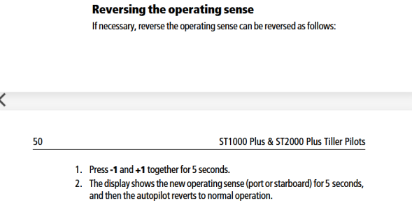

Kiwi Decision has mentioned the mounting position. The ST 2000 is factory set for port side mounting.
In the manual there are simple instructions to reset the unit to starboard.
These units are factory set to be mounted on the Starboard side.
Sorry for the incorrect information.
