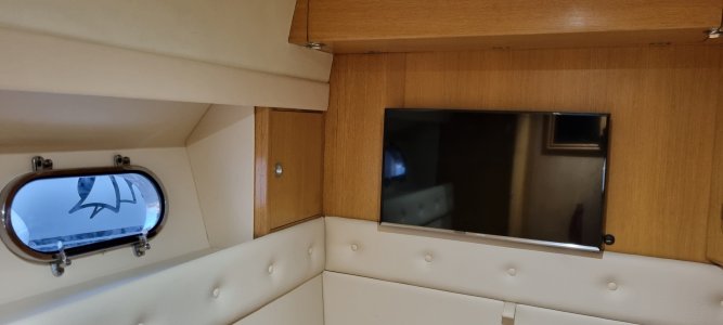

If sticking to ply, whether removable or not, waterproof PVA has worked well for me, as recommended by Hawkehouse.
1988 P45 guest cabin, refurbished to original spec:

I did some on my previous boat with contact adhesive and it was generally easier with PVA. For removable ply panels i did the plat surface with PVA and left to partly dry, then folded the edges round and stuck them with contact adhesive, on some small ones i stapled the edges (stainless staples).
The play around the portlights is fixed, but the slower drying time made it easier to get everything perfectly in place. It helped with some edges to temporarily stitch the edges in place with some 2" Sellotape, a small roller kept everything nice and smooth.
The small vertical panels have no foam backing, these were stuck on with contact adhesive.
