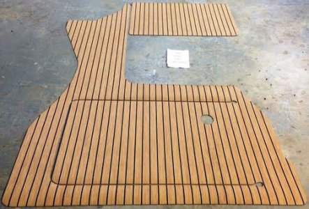

EVA foam teak sheets. Looks nice, relatively cheap and cut and fit like a carpet. Can be glued down or use other type mechanical fixings. velcro pads, press dot canvas type fixings, screw and cup washers, etc etc. Depends how much you need/want to lift it.

I like the idea of the eva teak stuff, but i am not sure if it would look good on the curved bits on the hull? I've only ever seen it on flat, even ground.
