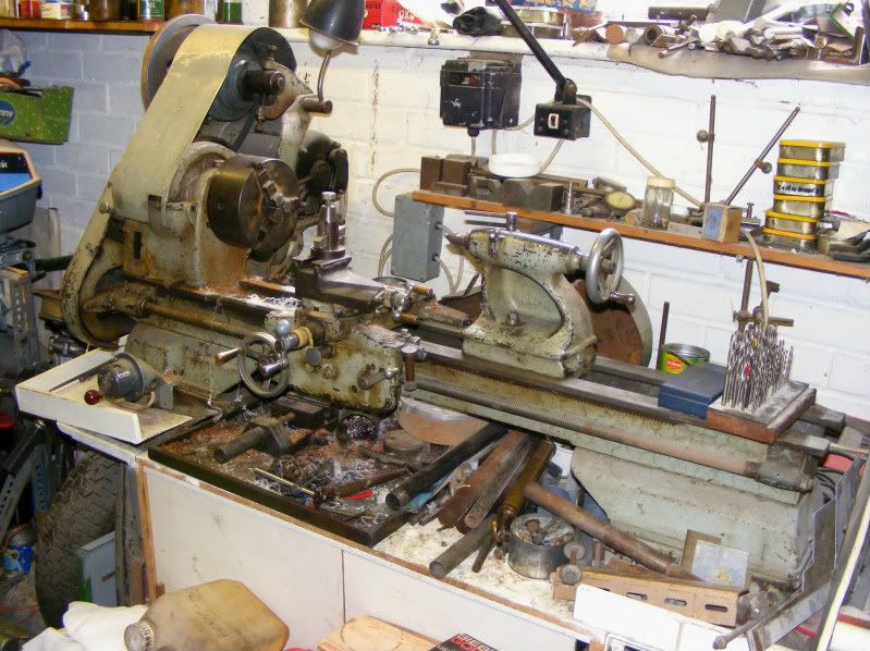

Although I have a Myford Super 7, the lathe I use most is a WW2 vintage 9 inch Southbend (American 4.5 inch centre height.)
I also have a WW2 vintage lathe, but it's a Drummond round bed like this one http://www.lathes.co.uk/drummondroundbed/
I bought it for £25 from a farm machinery sale in a very sorry state, but it cleaned up well and thankfully the head stock bearings were okay.
I wouldn't regard it as a precision tool by modern standards but for the few times I need a lathe it suits my needs. I have it hooked up to a 1HP motor via a variable speed drive.
