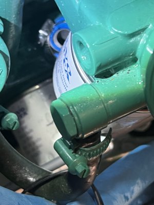

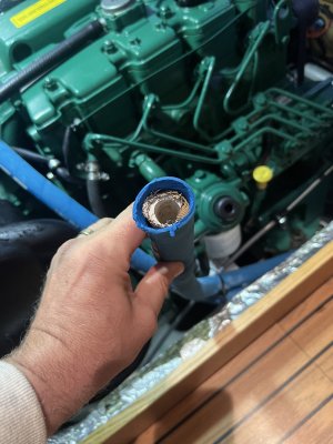

Burst coolant hose, first day of our sailing Holliday. It’s the water heater coolant circuit. Engine is a Volvo penta D2-75f 2019. Pipe seem to have ballooned and burst just at the hose clamp fitting behind the fuel filter. Beyond changing the hose, what could be the cause of this?

Looks like the hose has delaminated. Unusual ass that type of hose is usually robust. Not really anything to do with the engine as the plumbing for the calorifier is fitted by the builder.

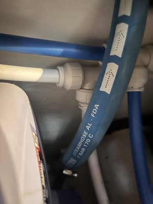

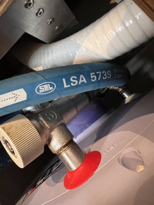

Thanks. I dont know whether the delamination was caused by the process that resulted in this, or if it was previously delaminated. Hose is rated for 7bar and 170 degree Celsius. I also suspect air in the calorifier as those hoses were disconnected during cooling water change. Some work was done to clear air after changing cooling water, but maybe not enough. Engine was also test run for an hour at high temp a few days before this so quite odd it didn’t burst then if this was the issue. Pictures here from water heater side.

As it turns out, this was Indeed a bad hose problem. The original high tech hose started to break down. Now changed to a more traditional rubber coolant hose. Run 150 miles with the new hoses thus far and all seems ok.
