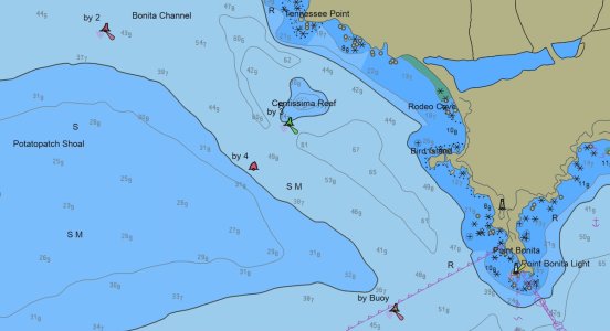

I would expect a cardinal mark to be used around more localised and isolated hazards, such as Centissima Reef in the (IALA B) example below. Which of course doesn't have one, because as already mentioned the US tends to stick with the lateral system. Regarding the "wrong side of a buoy", I've always been taught that one should never cut a buoy unless very sure of the safety. Buoys have a swing radius after all.
Here, the main shipping channel runs E-W just below the preferred channel buoy at the bottom. This of course works well for outbound traffic, as it acts as a starboard-hand buoy for the main channel, and a port-hand buoy for the smaller Bonita Channel.
In contrast, incoming traffic gets a reversed picture which would cause confusion were it not so far north of the main channel. They'd need to refer to the chart to know to ignore it.
