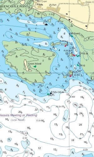

That is true, and in the era of GPS and electronic charts unlikely to lead to trouble. But worth understanding as in the example below a starboard course is considerably more challenging than the port one!
Surely the guy who made that chart up could have made up a slightly saner use of a GRG!?

It's doesn't really matter but plenty of other places use a Cardinal in exactly that situation.
Doesn't really matter because the chart makes it clear what's going on but I'd personally prefer a cardinal there. Would feel a bit odd leaving a flashing green to port when going rock dodging into that anchorage.
