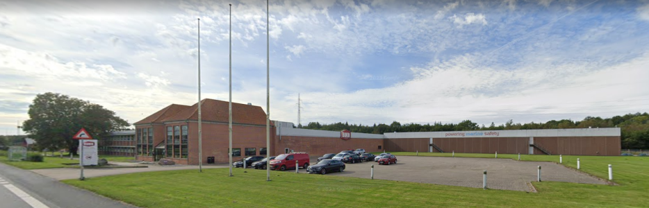

Or call them - one of the manufacturers that still are around
