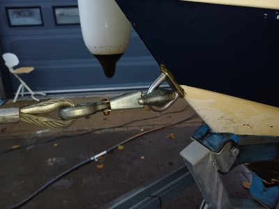

This is what I need >
Boat is approx 1.1T ... 24ft planining hull onto a multi-roller trailer ... so the eye needs to be strongly mounted ... as the boat is winched out of water up onto trailer ... not floated along it as older style trailers.

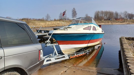

Old trailer that was too short and put excessive UPWARD stress on the car hitch >

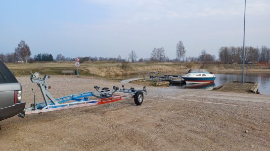

Replaced with trailer suited the boat size and double axled :
As can be seen - this is designed not be be fully submerged - but to winch the boat up onto.

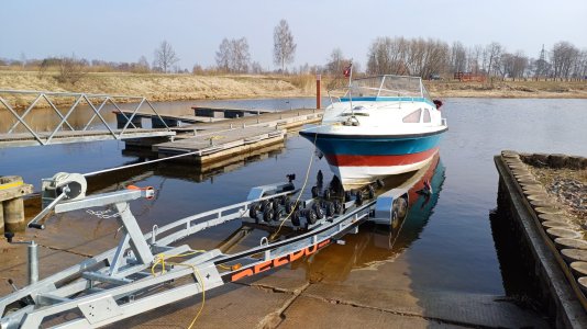

Here next photo you can see the disparity of the winch and boat winch attachment point ..
