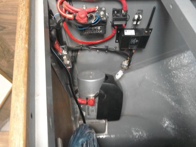

The thruster was professionally installed. As the photo shows very neatly. The battery is the other side of the bulkhead and the windlass is immediately above. There is an isolator on the berth front on the left. This means all the heavy cabling runs are very short. The charging cables are not installed at this point, but now run along the left hand side before going through the bulkhead to the battery.
