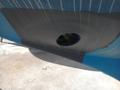

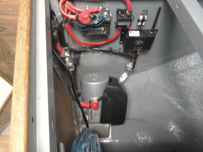

2022 prices approx £4500. Don't have exact price for complete job because I already had a bow battery in place to run the windlass and I did the cabling upgrade to charge the battery through a B2B from the start battery. Also did not run the hard wired control back to the helm because it is a tiller steered boat and nowhere easy to site the control so have a wireless remote that does both thruster and windlass. The thruster was a Sidepower 55 which was an older model but unused at the time. a 60 would be fine for your boat and I would think £5-5,5k would be about right. Photos show installation and battery is the other side of the bulkhead. It is a 115Ah Numax Leisure which came with the boat, but I would have used a 95Ah Exide stop/start AGM as used in diesel Range Rovers through choice. That is what was in my last boat.
There are 2 schools of though for powering it and like Robih I am firmly in the dedicated bow battery camp. Much easier for cabling and cost wise little difference - the lower cable cost is offset by the charger, but far easier to route the cables through an existing boat. My previous boat had a factory install and all the cabling was installed before the interior was fitted. I
