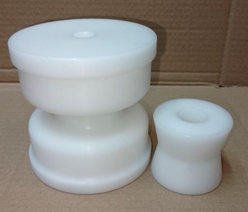

Thanks, but these stemhead fittings weren’t produced in volume. I’m expecting to have to have a roller turned up.

That’s really kind, thanks. I’ll try and get some accurate dimensions for the chain guide groove over the weekend, a pic, and send you a PM. Width of the roller is about 110mm (but I’ll double check), 100mm diameter and machined for 10mm chain.

As per #25, DinghyMan did indeed produce a new roller, thank you sir! Great job at a very fair price. Your assistance is much appreciated.

Will acetal/Delrin be robust enough in this situation?
What material do you think they need to be?
Given that most are either acetal, delrin, or a grade of nylon, and there is little difference between them, or just an unidentified plastic, properties and grade unknown - but we do make them in stainless as well from time to time
Just an observation. My anchor roller is brass (maybe bronze) and my mooring strop roller is acetal, which I replaced about 6 years ago and is now showing signs of wear (I have a spare).
Your caution is noted, thanks. The previous roller was probably original AFAIK and thus 28 years old - and this boat has done a LOT of anchoring, cruising in areas where marinas are rarely an option so I live in hope 🤞!
