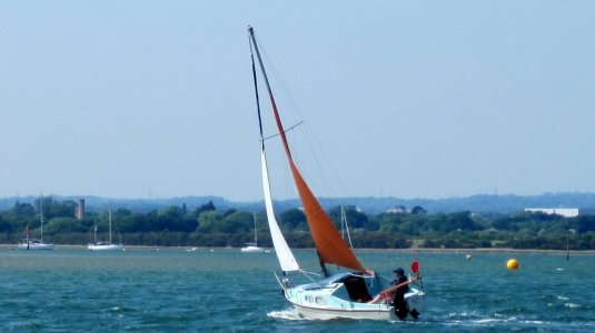

Never had a problem with sail shape (but I have a length of pool noodle if it ever becomes a problem) and I'm ok with roller reefing - yes I know it's old fashioned, but I have a main with sail sliders, and slab reefing would just be too difficult with the mast opening/setup I have on the mast (in essence, I can't close out the sail entry slot easily because of the shape, so every time I used slab reefing I'd have to re-feed sliders whenever I took it out..)

I think the answeer to slider problems at least for the first reef is to simply remove the sliders. The clew attach point should be such that the clew is held close to the mast so removing pressure on sliders when luff is tensioned. So ok with out bottom sliders. Or at least worth a try if you have slab reefing and sliders.
I just have bolt rope in track with a feeder. ol'will
