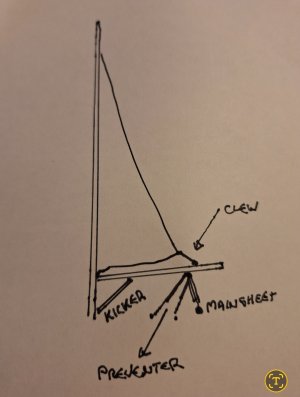

It all depends on the specific boat and the boom/sail/sheet configuration. My situation is a roller furling main, mainsheet 3/4 along the boom from the gooseneck, conventional rope kicker 1/4 along the boom. And I am cruising not racing. When running I tuck a couple of rolls in the main as it's easier to reef further if needed once started. The result is that the clew outhaul ends up pretty much where the mainsheet fitting is, and if I have the full sail out then I can use the boom end plus mainsheet positions to attach the preventer . My research and understanding of physics says keep the loads at the same point on the boom and avoid the leverage effect from well separated load points. Illustrated below. The boom is held firmly in place by the sail, mainsheet and preventer acting at more or less the same point on the boom.
With a slab reefed sail using the boom end would be my choice.
I recall sailing a roller reefing Centaur and developing amazing boom bend from no kicker and end of boom sheeting. A double claw ring 2/3 along the boom fixed it but for all the reasons above did not make a good preventer.
I would like to add a boom brake (and not use the preventer on a dead run) as I understand cushioning a gybe is better than stopping it with a jerk. But I do have a concern that fitting one at the kicker position creates a big leverage along the boom to the clew.
