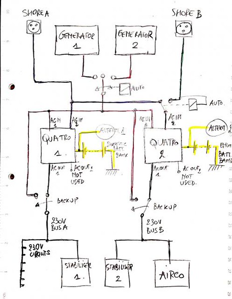

Here as promised, a blockdiagram of my installation, how I want to make it,
For now, I didn’t use the AC2 inputs yet, I just replaced the older Multiplus by Quatro’s .
The multiplus didn’t have this second AC in.
I didn’t change anything on the existing wiring yet,
So there still is a old selector switch to choose between 230V from shore or from a genny connected to the AC1 input at this moment.

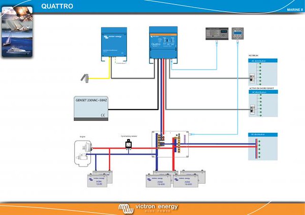

This is a diagram from the Victron brochure, and probably most appropriate for MapisM potential installation
Both the Multiplus and the quatro have a second DC connection for start battery’s, but I didn’t find a diagram where Victron use that one. (lots of info and examples on their website)
Some specs:
the Quatro 5K, can deliver 120A charge current to the 24V domestic battery’s and 4amps to the 24V starter battery.
ACin 1 or ACin 2 can pass 230V 100A through the 5Kw Unit to the AC1 out.
The invertor can deliver 5Kw (approx. 20 Amps), on the AC1 output, or can deliver this in addition to the 100Amps coming from one of the AC inputs

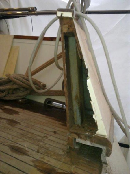

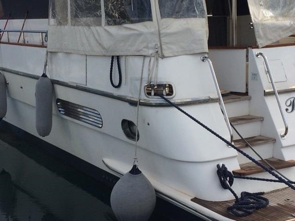

First is repairing some damage around the main fairleads in the transom.
Right before last summer season, we had this severe damage on port side, caused by One big wave coming in to the Tiber river in Rome;
when moored alongside, one of the spring lines, pushing the fairlead 15cm forward, damaging the plywood shell severely, on inside and outside.
I’ve reinforced this temporarily myself, to keep the metal fairlead in position, and put white gaffa tape over it for esthetics
Here are the pics,
Port side damage covered with white gaffa tape
From the outside, also covered with gaffa tape
Last summer, The SB side got some heavy stress from the mooring ropes, during a big thunderstorm, while being stern moored in Cavtat
you notice the cracks in the paint,
the plywood underneath is severely gone bad from moisture during years.
Last month I spoke with the former Canados yard team boss,
He explained me that this curvature was preassembled in the factory, and made from several thin layers of plywood.
The outside panel is 12mm and the inside is 10mm marine ply, mounted on solid wooden frames
the shape, size and curvature needs to remain exactly the same, for perfectly fitting the orriginal fairlead
Today I met two separate potential candidates for the repair,
Both proposed to do something else then repairing like originally build,
The first (3 folks from a local yard) proposed to replace just a few rotten patches, and place new sheets of GRP over the total surface,
The second (one local man , wood / GRP repair business) proposed to make a mould over the existing shape, and then produce a new GRP panel from that mould and replace the complete panels, both on the inside and the outside.
Here are some pics / cross sections from a few years ago, while making the transom door, and the transom gate,
to understand what’s behind the plywood shell.
I do agree that this construction is not good on long term considering moisture inside, as previously discussed in another thread.
this is a weak spot of this Canados.
What does the forum think is the best way to repair this ?

Just out of curiosity Bart ... and not sure how this would fit in with the rest of the construction.... but as this appears to be a high stress area, what about some metal work ?? Rolled sheet SS to curvature (Painted), welded stringers across to keep spacing and additional through deck bolts (and back plate) to prevent new the curved fairlead unit's load putting additional (or excessive) load on the original bulwark it will be connected to ?
Stack of sheets ?
Hello
Looking at the cross section and the stress cracks on the hull, it looks as though the lacks of "bridging" between inner and outer hull could be the root cause.
The stainless side walls of the fairlead will always survive, now matter how high the tension on ropes is... and the plywood hull sides will loose the battle for lack of backing. Could it be a solution to "build a small wall" of horizontaly stacked plywood sheets - and make massive connection between inner and louter skin ?
A final sheet of plywood - both on inside and outside could be added in minimal thickness (as low as 3 mm ?) to follow the complex curves. Or sanded, filled, faired etc. to make any curve possible...
Max thickness available in marine grade WBP is 25mm, a single sheet of 244 x 122 cm will make loads of L shaped forms. Canados.jpgRough sketch enclosed.
I definitely would not use #1. To get the strength ui need the laminate will be 10mm+ and that will look awful on the outside
I quite like #2. I would want more detail on how they will join the GRP to the plywood. Also, when they make the new external moulded GRP panel, I would want them to mould it heavy (like 15mm) and mould a 15mm flange at the base as wide as the flange along the top of the hull mould (125mm?). Then attach the new component to the hull flange with M10 bolts, penny washers and 3M 5200. Obviously, the new inner panel would then have to be attached last. The inner panel also needs to be a thick lay up.
As said above, the inner and outer panels need to be connected, so the yard should mould ribs on the inner face of the outer panel, then glue the inner panel to the outer with Crestomer on the ribs
Very roughly indeed, the outer panel would look something like this:
I tend to agree with Divemaster1 and MarkNL. All the load from the fairlead is resisted only by the 12mm outer panel and the 10mm inner panel of the bulwark construction and as you well know, with stern to Med moorings, there are huge loads on the fairleads due to wind and swell so no surprise that particular construction has failed. IMHO you need to find a way of transferring some of that load to the deck and I like what MarkNL has proposed ie building up a laminated plywood block around the fairlead (which would obviously have to be curved to suit the curve of the bulwark) and then bolting it or screwing it to the deck underneath. If you did that, I don't see the point of using grp at all to repair the bulwark which I don't like anyway because wherever it joined to the original plywood bulwark, there would be the possibility of cracking at the join. Also I guess the look and texture of a painted grp panel might look very different from the rest of the original painted plywood in the bulwark. So if you found a way of transferring the load from the fairlead to the deck, either with a block or some other means, then there would be less load on the existing plywood bulwark structure and I would be inclined just to do a repair job on the existing plywood panels, either by patching them or if they were too damaged, replacing them
All IMHO and ready to be flamed by more learned members!
Howsabout carefully remove the inner plywood, then weld a leg and a base mount for the fairlead as pictured below, using very strong eg 8mm st/steel plate and maybe 100x50 box section for the leg. Then 5200 that and M10 bolt through the hull top flange, then replace the ply panel and generally fill/repair the plywood, maybe cover with GRP sheath and make good (as Vas has done, using epoxy, etc)
This feels to me like a low cost/low labour solution. The st/steel doesn't need to be polished even. Yet it would be very strong. Make the base plate as big as possible to spread the load - bigger maybe than my sketch suggests
Bart, coming to think of it, I see no reason why the gunwale should support the whole fairlead structure and its load.
I mean, your main stern cleats are placed directly on the deck, so why shouldn't be the same for the fairleads?
You could consider opening a bit larger hole in the gunwale, throw away the existing fairleads and place completely different fairleads on the deck edges, fixed only to their bottom.
I'm sure to have seen this solution on several boats/yards, but the only pic I found that gives at least an idea of what I mean is the one below.
Btw, in this Azi I think that the fairleads are still raised above the deck, because also the cleats inside are - but you see what I mean.
I suppose one potential problem on BA might be accessing the deck corners from below, in order to fit thru bolts, possibly with counterplates underneath.
But if that would be feasible, you could forget any need to strengthen/modify the gunwale.
Just a thought.... :)
Howsabout carefully remove the inner plywood, then weld a leg and a base mount for the fairlead...
I only saw your idea after posting mine. We are thinking along the same lines, I reckon. :)
Your proposal has the advantage of using the same fairlead and keeping the OEM look, while mine requires more adaptations.
With both, it has to be seen how accessible is the deck from below.
Anyway, imho either ways are better than trying to strengthen the wooden gunwale, which by its nature is not built to withstand concentrated snatch loads.
